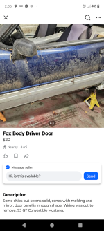

So I needed a mirror and had been watching the usual sources so that I didn't pay too much. Well, this popped up about 3 miles from the house:
From the picture, I expected the door to be rusty...nope. I will have some spare parts...more spare parts :-D
