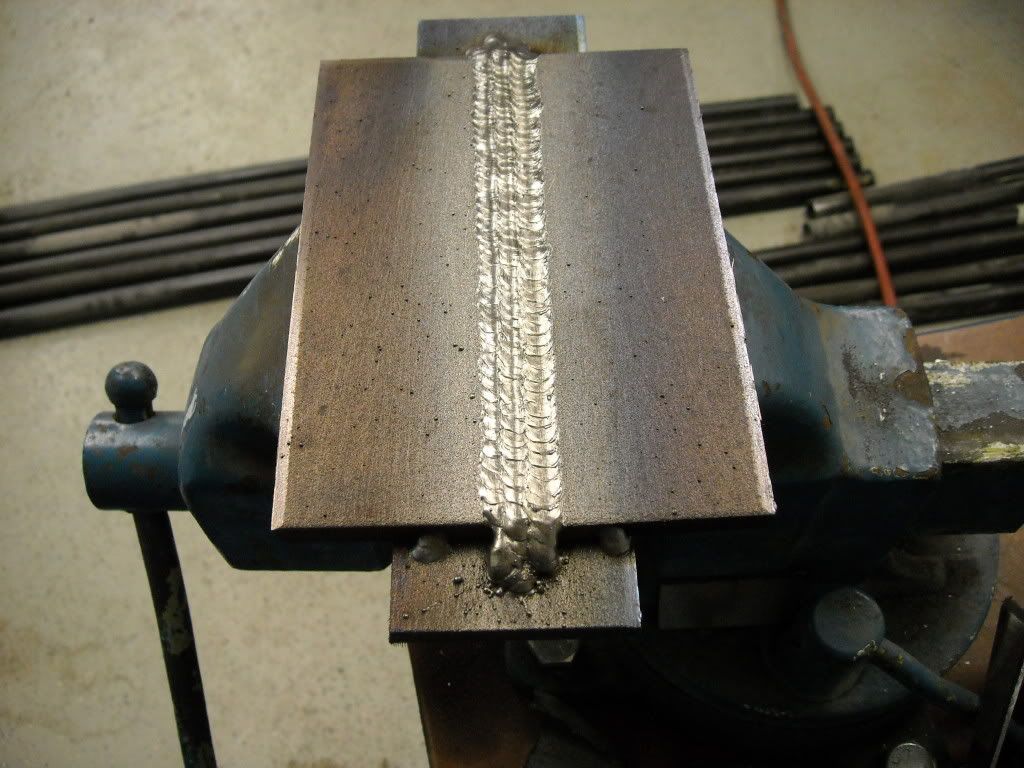

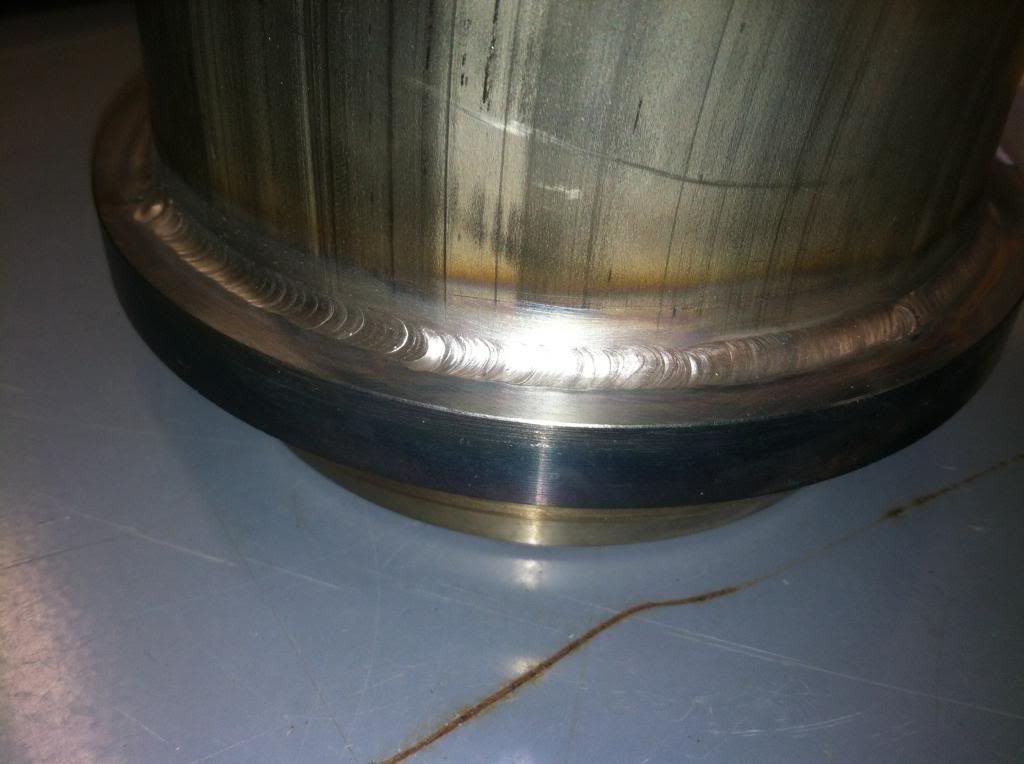

with my Miller diversion 165 TIG
With my Miller 211 MIG
